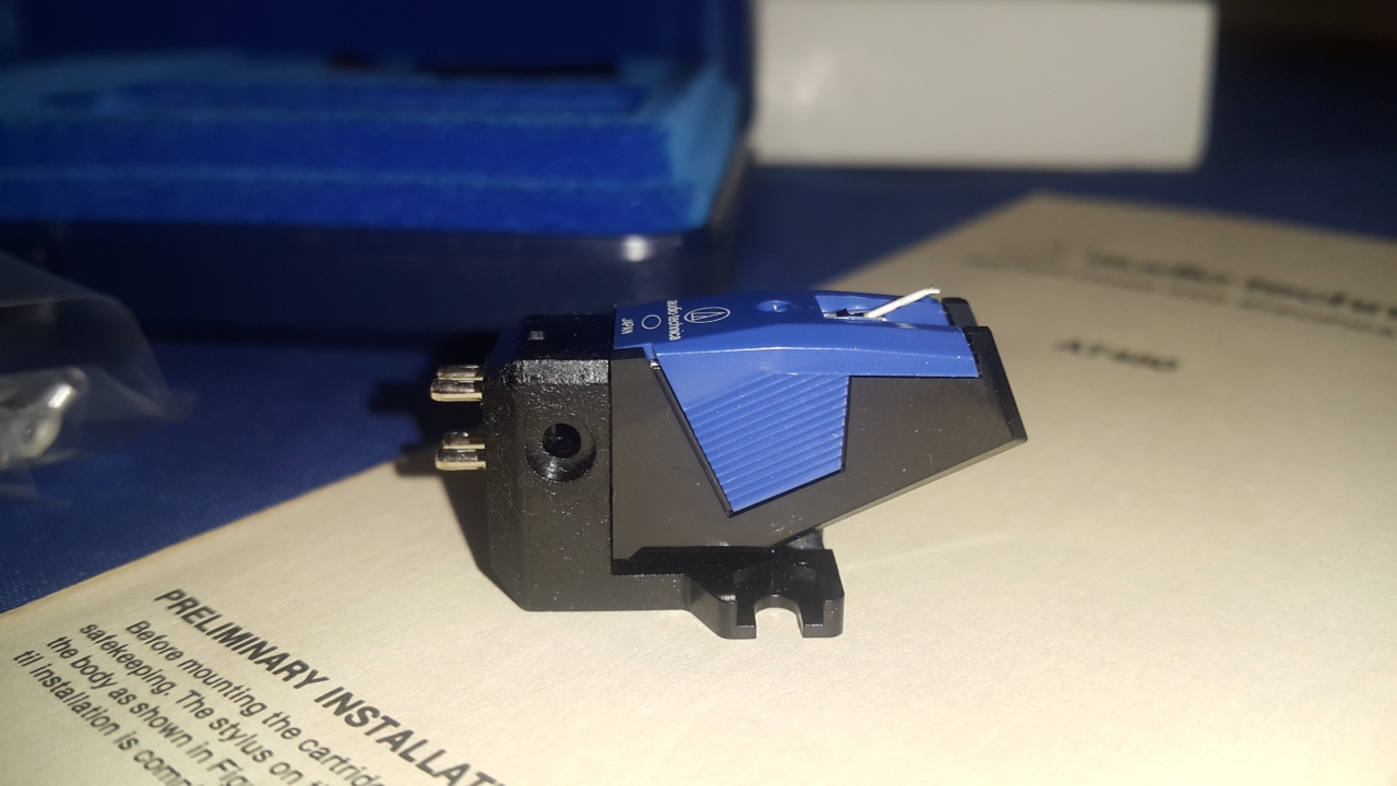

4. Audio Technica AT450 p-mount ( nude ellipitical )
Empire 1000Z/EX
Piezo YM308
